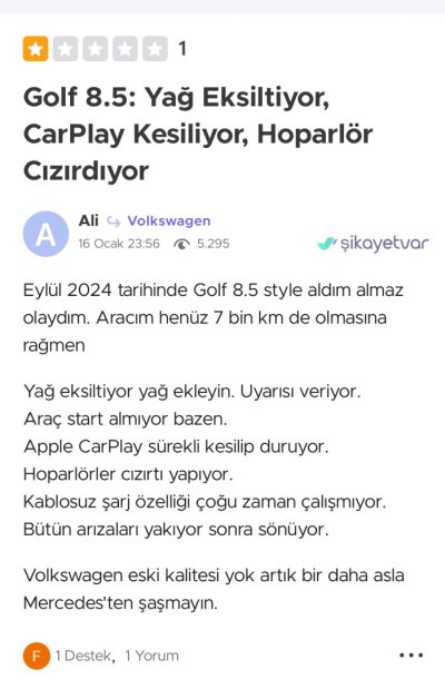

https://www.sikayetvar.com/volkswagen/volkswagen-golf-85-ariza
